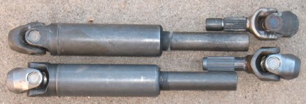

OK, here's what I did.
First of all, there's 2 different styles of 1100 shaft (kardanwelle), older and newer type. The splines for the gearbox and the differential are the same, but the splines at the end of the shaft and the linkage is different.
I used the later model.
I fitted the 'kardanwelle' adapter, an 1100 shaft (late model ) and a 1150 swingarm, and measured the length. The shaft (kardanwelle) is a little bit too long, so I machined a few mm of the end of the shaft.
Top: old type, Bottom: new type, both 1100 shafts
Works for me, maybe there's other solutions.
Best of luck.
