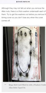

in the timing cover there are n.9 M6 bolts and 3 barrel nuts BMW part number 11 14 1 252 311. Under these are washers which are thicker than those under the bolts. I can't find the BMW code or measures to find replacement washers. can any of you help me?

on the drawings they are not indicated. on my 1991 R100GS there were three under their respective threaded bushings. unfortunately I can't find them anymore.

hello, I bought my 1991 bmw r100gs used.
Even if they were stuck into the cover, There were washers under the Allen nut part 10 which is positioned incorrectly on realOEM. Also on the drawing relating to the bmw r100rs from 1983, there are no washers and part n.10 is in the wrong position. Anyway, mine was just curiosity. I do not want to waste your time or make you think that I’m polemic or that I have a high and controversial tone.
