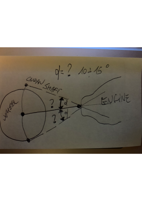

Hello everybody. I hope my English is clear and the English-German translator works correctly. I searched the forum but did not find a topic that could answer what I would like to know and understand. I apologize if my questions and considerations are stupid or wrong, I'm just trying to learn something new. The theme concerns the BMW g / s and GS transformed into "real enduro bikes". I know that frame and swingarm changes are necessary when you want to have a taller bike for off-road use with longer forks (930-940mm from top to center axle, 280-300mm travel) and longer travel shocks ( stroke 260-280 mm). I know that the frames are reinforced, that sometimes the angle of the steering head is changed (I think reduced - more closed angle), that the swingarms are lengthened and / or the position / length of the shock absorber is also changed and sometimes the position of the motor in the frame to have a better angle with the cardan shaft.
That said, I'd like to know if what I've guessed is correct or not:
in practice, raising the front with longer forks (with more travel) I have to strengthen the frame to withstand the greater stresses to which it is subjected. I also have to balance the increased height in the front by lifting the back as well. This is to keep the steering head angle within a certain limit (it must not open too much and remain between 28 and 32 degrees). Furthermore, I must pay attention that the angle of the cardan shaft during the travel of the wheel does not exceed certain values, causing incorrect operation of the coupling. for this reason the swingarm is lengthened (usually by 100mm in combination with forks having a length of 930-940mm and an excursion of 280-300mm).
is what I wrote and thought correct?
you could also tell me
1) what are the extreme values ​​of the work angles of the cardan shaft?
Look at the picture.
Thank you very much.

1) Was sind die Extremwerte der Arbeitswinkel der Kardanwelle?
Sehen Sie das Bild an.
Vielen Dank.

The whole things only works with a G/S, not with a GS, because maximum allowed cardan angle on a GS is not sufficient for the planned deflection.

Regarding the GS frame, due to the dent I knew that there could be more travel to the rear wheel than a g / s frame.
problem with paralever is not moving restriction caused by the frame but the paralever shaft / paralever technique itself.
this obviously replacing the paralever transmission with a monolever.
Regards
understand and I agree thank U.
